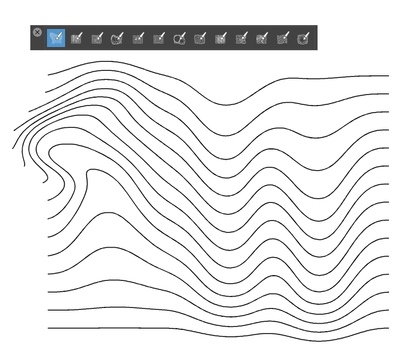

    Customizability is important to me, and fortunately Vectorstyler offers a lot
    in this respect. However, the Toolbars could be a bit more flexible. In CorelDRAW / Xara,
    I always created my own toolbar. I'd rather like to use the mouse, than tie my fingers in knots
    with keyboard shortcuts.
    I don't really know of any program where I admire the user interface, but there are
    some that I don't use because of it, Adobe Illustrator is one example. Corel Draw
    has abstracted its icons more and more over time so that they have become illegible
    in my eyes and I no longer like working with them.I found earlier versions better in terms
    of legibility.
    Here a Video how flexible Corel Draw Toolbars are
