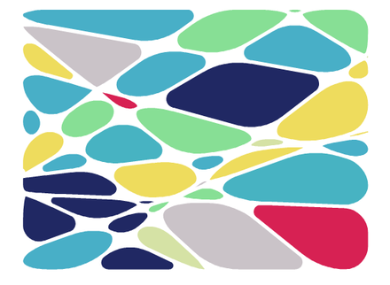

  • I know there are online Voronoi pattern generators,
    but here's a way to a create similar looks in VectorStyler.
    The key here is to use the "For Each" option in the Transform
    panel, which moves each path individually.
    Here the Video

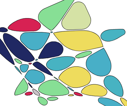

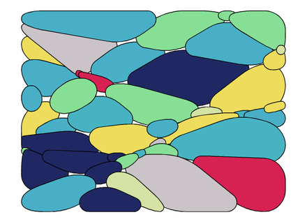

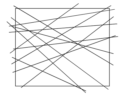

  • An additional note:
    You may achieve a somewhat better look if you surround
    the randomly transformed paths with a frame.
    Btw. the frame doesn't have to be rectangular.
