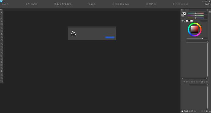

 The only folder within the Roaming subfolder path are those of V1.0. Even removing it from there didn't make a difference it all remains one gray/dark theme without readable menu/texts (incl. dialogs) so I can't see whatI am selecting. See image below. Copying the folder from the Local subfolder path to the Roaming Subfolder path didn't make a difference either.
 @Arte This does not seem to be a theme error, and more like missing text resources.
 Remove all VS data from the Local sub folder (back up the license and presets).
 Also, uninstall VS completely from the Programs... folder (make sure that it is removed).
 and then reinstall from the MSI file.There are known problems with MSI installers that sometimes does not update all the files correctly.

 @VectorStyler Thanks, I'll do that. The license file was still there but it seems I got a license registration dialog. I can copy the files from a backup and will use those to put them back after a complete removal and reinstall. I'll let you know how this went.
 @VectorStyler It is working again, I had also copied the config file back but that caused the problem to arise again. After deleting the backup config file it worked normal again. It did comment about the license data loading successfully but I had to verify it by putting the userdata and license key again into the registration dialog. Should it happen again then I'll try the above steps for a complete removal and reinstall first.
