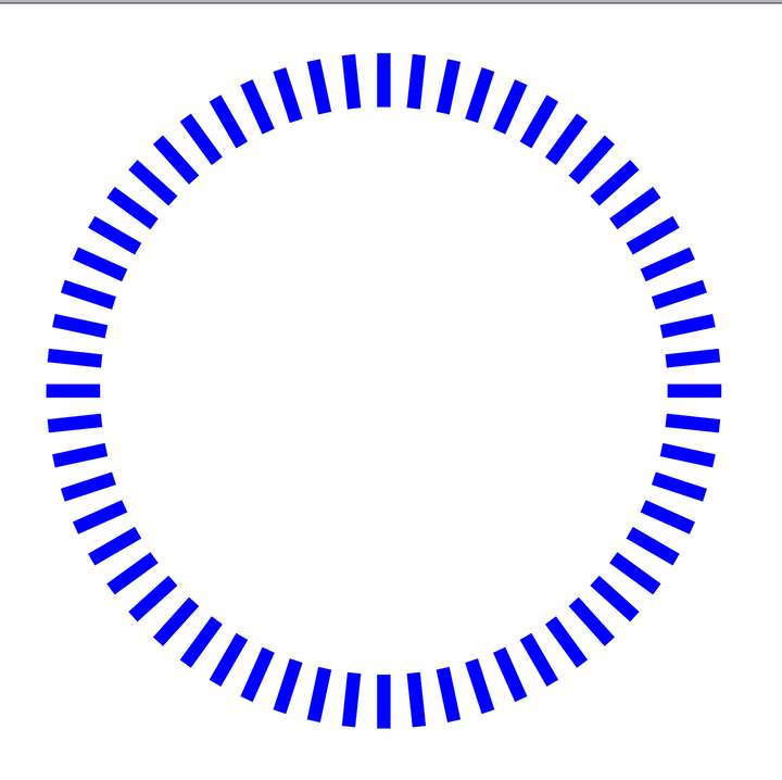

  • @Subpath Maybe this will help clarify what I have been describing. This (blue) is what I start with in VectorStyler:0_1732058316464_Blue Start.png

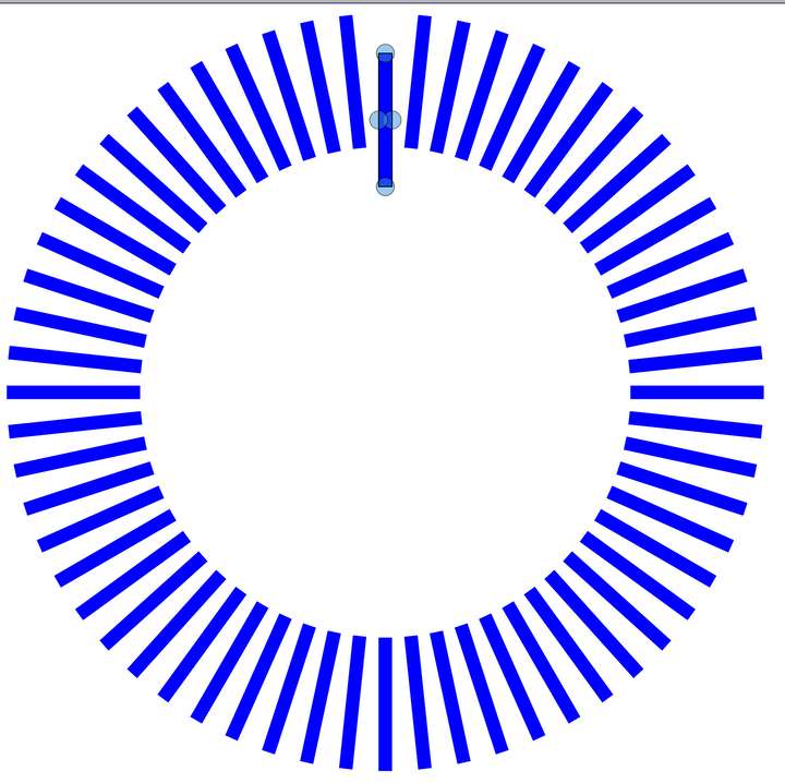

    Then I modify the source object by lengthening it toward the center:0_1732058377622_Blue Misaligned.png
    As you can see, the clones are also lengthened, but they are no longer aligned with the source object. I need them to stay aligned.

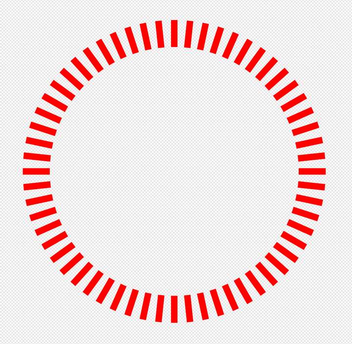

    The red example shows what I need. I start with the same shapes:0_1732058516651_Red Start.png

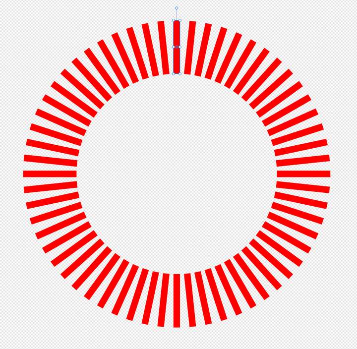

    Then I modify the source object in the same way, but this time the clones stay aligned with the source object:0_1732058590298_Red Aligned.png
