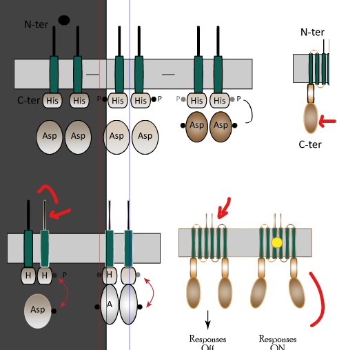

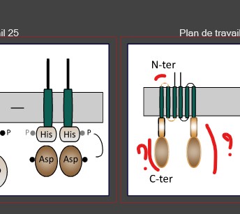

I was thinking of reworking an old AI file in VS (which opens perfectly in the current AI v 29.0.1). The artboards are not created and some strokes obviously don't have the right colour.
AI
VS

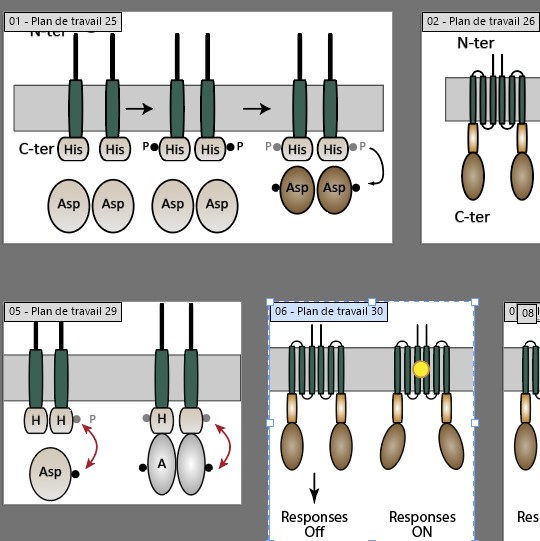

@VectorStyler Ok, I had just opened it in AI 29 but this time I saved it and reopened it in VS. The artboards are all there, and all that's left are colour issues with the strokes.
