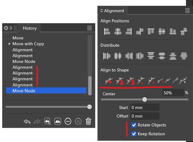

if possible, could the History panel specify the type of alignment used (if they are numbered, for example), and what this two option means (keep rotation)?

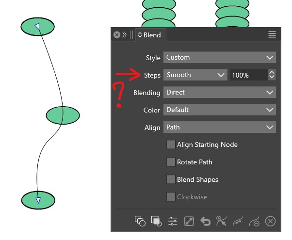

@VectorStyler I can't get that working. Perhaps I need to use the blending feature for this?
Well, I get something with blended objects but I would like the (long) axis of the ellipses follow the stroke shape. Possible ?

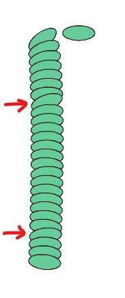

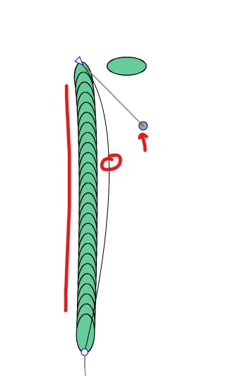

@VectorStyler ok, I found a way to do it by rotating the original objects but it seems to me that there is a bug with the ‘Smooth’ option:
I added this to the features backlog (will be done, but later).

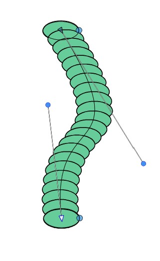

If the "Rotate Path" checkbox is selected in the Blend panel (or panel menu), the ellipse will be rotated according to the direction of the path.
