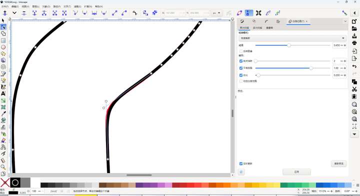

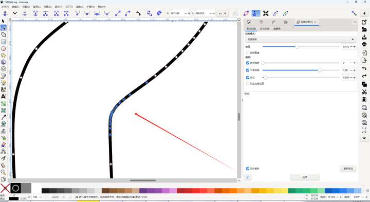

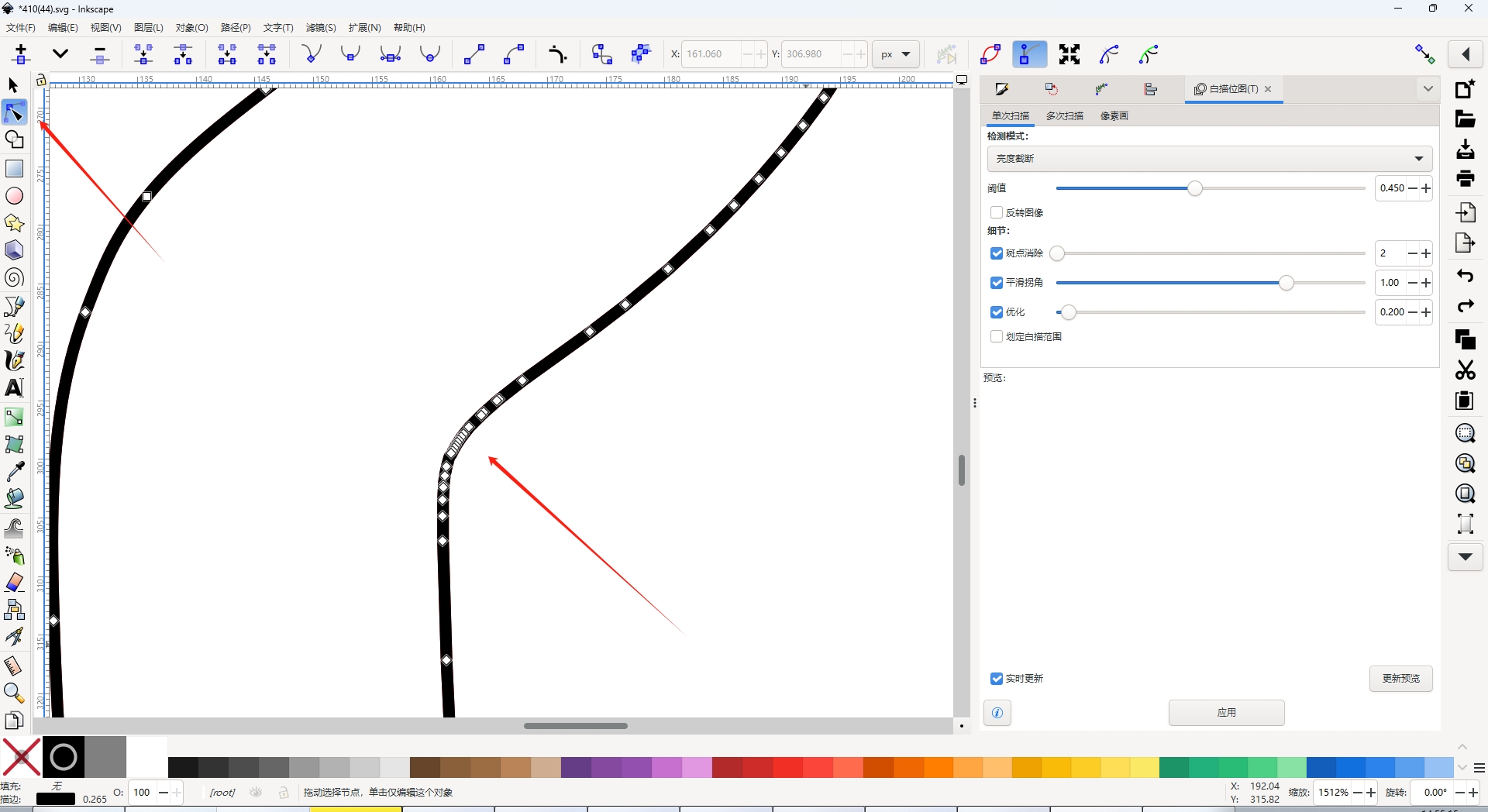

      Here are two overlapping paths. When using the node editing tool in Inkscape and Designer to frame - select nodes, only the nodes of one path can be selected for editing, while in VS, the nodes of both paths can be selected. Can the same effect as them be achieved in this regard?0_1728975902069_1.png 0_1728975906317_2.png 0_1728975909935_3.png

          @VectorStyler I tested those two software. In the node editing tool, when no object is selected, no node or path can be selected by frame selection. Only when clicking can a path be selected. To select multiple paths, you need to press Shift. However, in VS, nodes in a path can be directly selected by frame selection. So in the above example, the nodes of two superimposed paths will be selected simultaneously. For example, for two superimposed paths. I need to adjust the smoothness of the upper path, and keep the lower path to observe the integrity of the path after modification. This operation is very difficult to achieve in VS.
