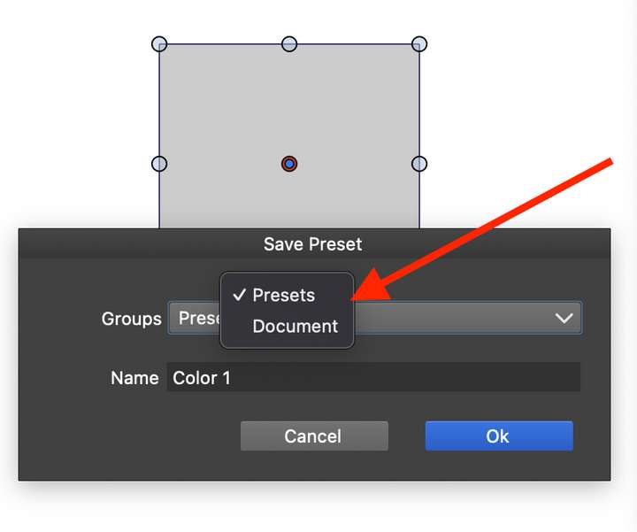

          Ok, I'm officially confused. I was under the impression that for "presets" you can choose whether you want them to be global or just for the current document - hence the option in the dropdown when you're saving a preset.
            VectorStyler @pentool
            @pentool said in Getting my head around abstractions:
            I skipped this detail for simplicity. Yes, you can also store presets in the document and these are available for the document only and carried with the document. Nevertheless, these are not linked (not styles).
