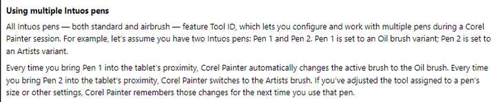

            @VectorStyler I've just found this on the Coral Painter website which might interest you, because it tells a little bit more about how it works there. Appearently the feature is not called 'Device ID' as I thought, but 'Tool ID'. Hope this helps!
            (BTW I already own Vectorstyler, so I'm not questioning this to buy Vectorstyler, so that you know. Keep up the good work!)
            Source:
            https://product.corel.com/help/Painter/540215550/Main/EN/Win-Documentation/wwhelp/wwhimpl/common/html/wwhelp.htm#href=Corel-Painter-Wacom-Intuos-Support.html&single=true

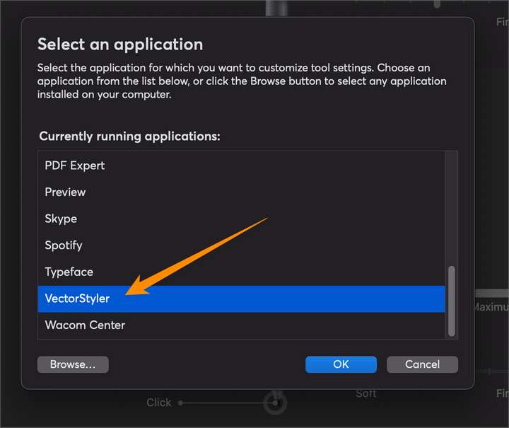

              I have a couple different wacom styluses that I use interchangeably on my wacom cintiq and a smaller wacom drawing tablet I can plug in to my laptop.
              0_1724454847629_20298bc5-54da-48b7-a54a-f3a35f4cf2e1-BLD 2024-08-23 at 19.13.17@2x.png
              I can choose what kind of settings the pen stylus uses on an individual program level. So theotretically, I could have different settings applied to each stylus in Vectorstyler and have it switch between them based on which stylus I pick up and use that any given time.

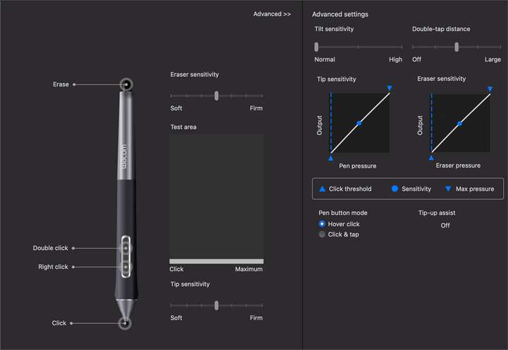

              0_1724454936679_dab18827-c89a-4919-92d6-210b12f2276e-BLD 2024-08-23 at 19.14.55@2x.png
              This is more for controlling pressure senstitivity and srtting up buttons and the like.
              This does not quite solve your question of getting specific brushes and settings to be the default on an individual stylus level.

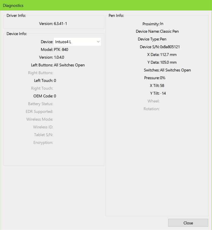

                I use the Classic Pen and the Art Pen with the rotation feature interchangeably for raster illustration. I also have an extra Art Pen around here somewhere that I could use, but it would register as a separate pen. I also have a newer, but smaller Wacom that will use these same pens as well and I imagine the Tool ID would read the same. It's something that can be seen in diagnostics when I have uploaded videos with a portion of the Wacom Diagnostic panel visible. It shows which pen is being used and its individual ID. Particularly where it says "Device S/N":
