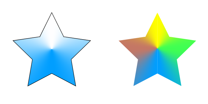

      I don't know if this is a question or a feature request. Maybe what I want to do is already possible.
      Anyway, I'd like to know if it's possible to have a conical gradient that does not repeat itself after the 180° point. Imagine trying to make a colour wheel or the Mac "beachball" wait cursor.
      With conical gradient, I can kind of solve it by splitting the shape into halves. The same effect would be more difficult for spiral gradient.
      Is there something I am missing, and there is actually some way to do what I'm trying to do without splitting the shape?

        @nocturnalYL There is a bug here, I will have it fixed by the next build and then it will be possible to have asymmetric color
