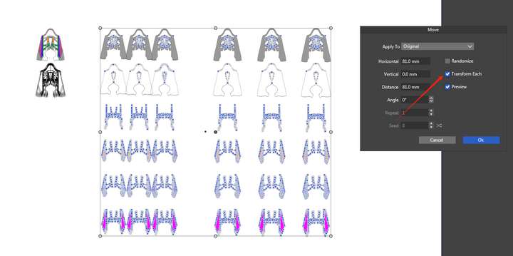

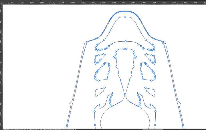

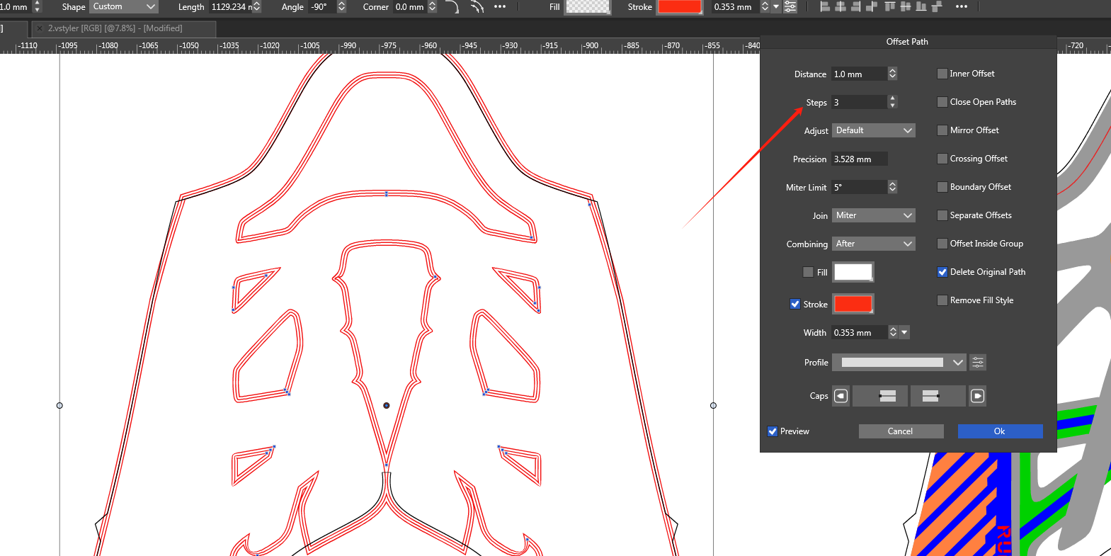

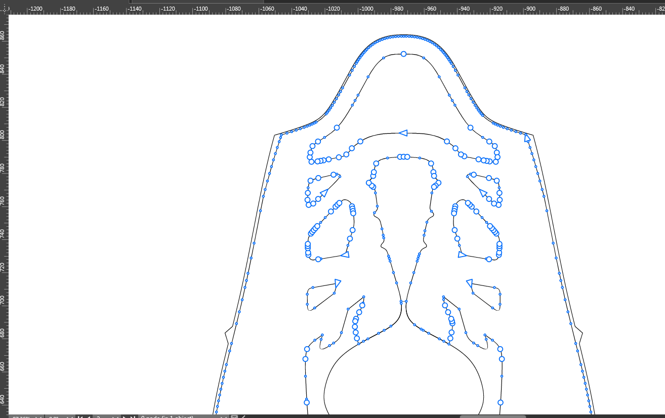

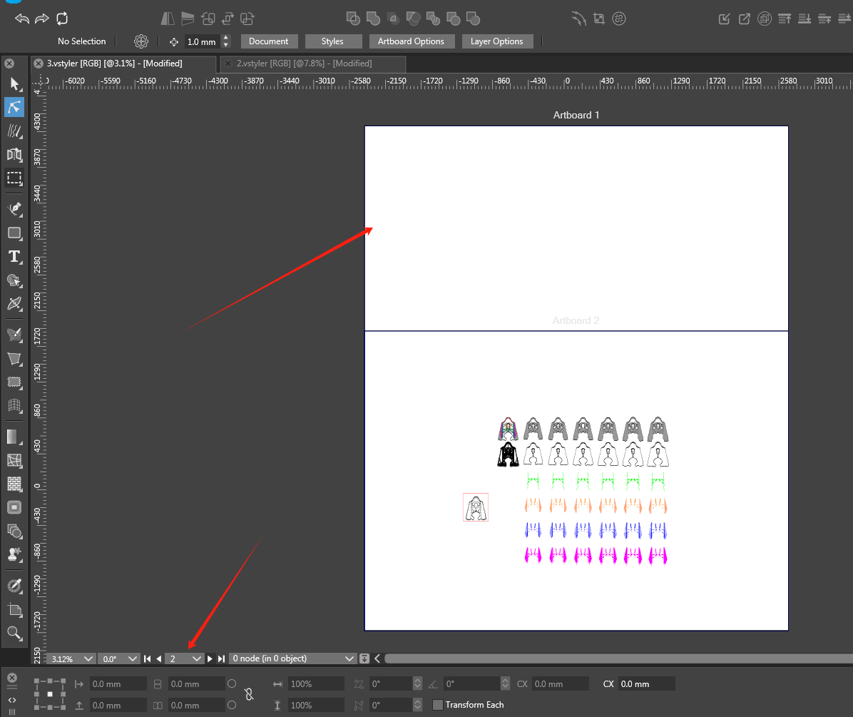

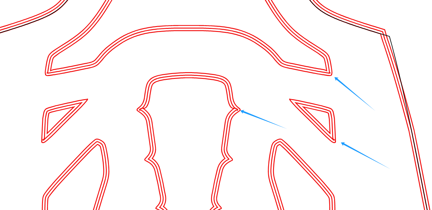

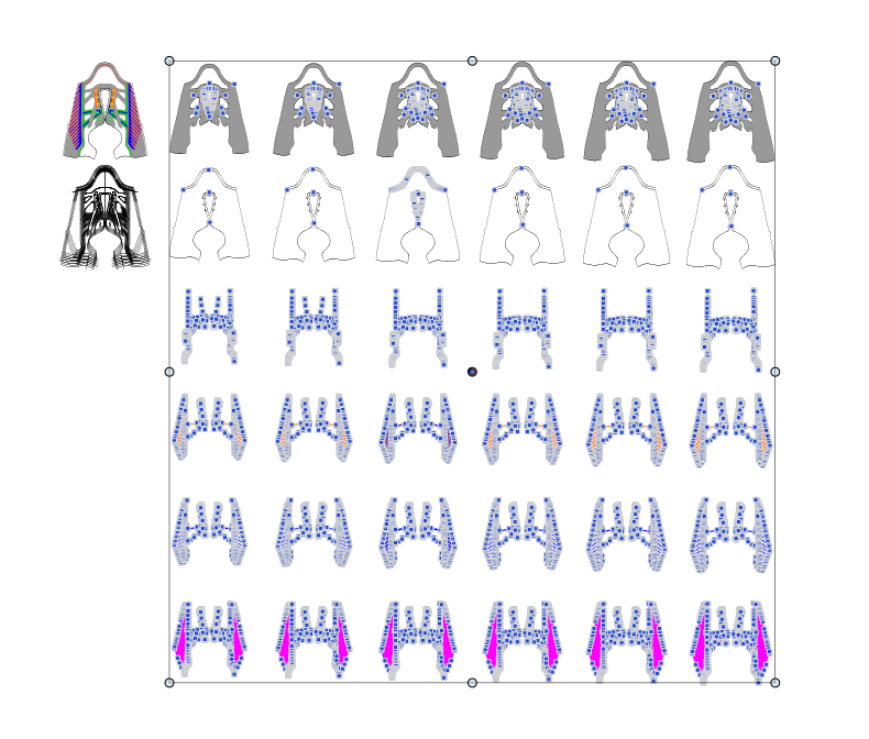

0_1719327278286_3.vstyler 1.In the case of not knowing how to operate, it appears that there are two canvases in the view, but when you delete the first canvas, there are still two canvases displayed in the position below, and the first canvas is independent and cannot be deleted。 2.Path offset error。 3.A vertical column is a group, a total of 6, and there is an error in the transformation - movement function.
@monsterfox I will open a bug on these. It is not clear what is the error in case (3).

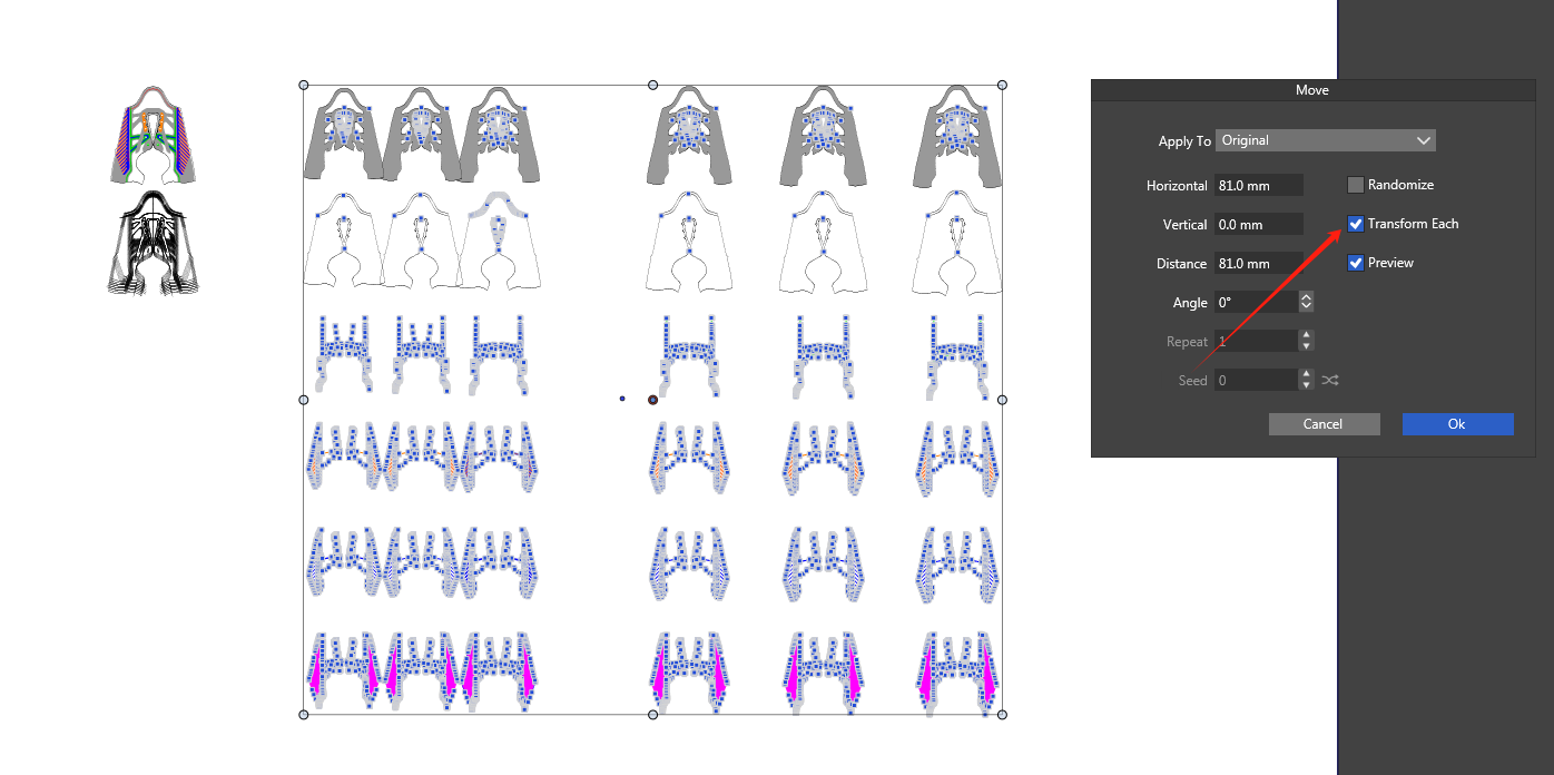

@VectorStyler Error 3: The two pictures are reversed, and the distance of each transformation should be regular, but the effect is already chaotic.
@VectorStyler The third question has not been solved yet. Maybe there is something wrong with my expression. I will record a video tomorrow.
@monsterfox I opened a new bug on this.
@VectorStyler Post question 3: At that time, due to the absence of video, you misunderstood. The function of incremental transformation of each has been lost, and it is hoped to restore the function. In addition, there is this checkbox in the transformation panel, but it seems to have no effect. I hope to check it. Thank you.
