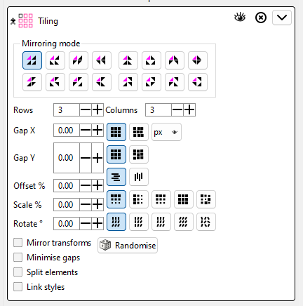

This is the effect function in Inkscape, which has a very high degree of similarity to the Repeater function in VS. There is no problem with Inkscape in this operation. Can you study it? Is it possible to refer to its code to fix this issue?
@monsterfox What happens in InkScape if you have a grid repeater with a shift?
@VectorStyler https://youtu.be/xarCyAoHIgQ?feature=shared
Haha, sorry, I made a mistake in my memory. In Inkscape, only one of the shift options can be selected. Theoretically, it seems that two coordinates can be enabled for this function, but there will likely be conflicts. Let's just set it according to Inkscape's way for now.
@monsterfox said in Repeater's shift issue:
yes, in this case the pattern gap is not show.
