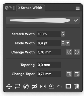

    @VectorStyler can you check out the stroke width panel? I get nothing out of changing the values in the Node Width field, but the values change when I use the Stroke Width Tool with the selected node. The input field does nothing even after that.
    I tried changing values on nodes on a curve I had just drawn, and it says hairline. It's possible to change the value with the slider, but when you select a value on the slider, it changes back to hairline again.
    If you can only change the value on nodes that have already been modified with the Stroke Width Tool, then there should be at least no option to change it. On the other hand, it wouldn't be unreasonable, I think without having much experience with stroke width tools, that by changing the value, you convert a conventional node into a variable width node.

    Seems it works hereVS 1.2.020
    is working also in 1.2.023
    also no problem using the slider
    Here the Video
    @Ingolf said in Stroke Width panel - broken?:
    I will test this.

  • @Subpath said in Stroke Width panel - broken?:
    Thanks buddy - like in your example it works like a charm on my mac as well.
    So what confused me as a stroke width beginner ins VS - was that I used the panel out of context and before it was ready for input, so to speak.
    I agree with Xiao that it would be very handy if entering a number in the panel converted the node to a variable width node before using the dragging stroke width tool. Maybe it is even easier to implement than a lot of usability code with interface feedback. 🙂

    I think I understand the problem
    If not, at least one width node is selected
    The “Node Width” field does not change anything
    btw the label “Node width” gave me the idea that maybe one
    or more width nodes must first be selected
    but a new user might get stuck here ?
    @Subpath I will try to add the width selection for path node also. The problem is that this will create a new stroke width node that will not follow the path node.
