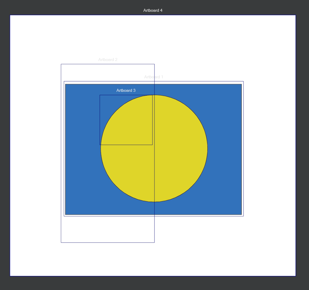

      I'm running into issues when exporting artboards in 1.2.022. on Windows 10. The initial artboard created with the document works fine, but any changes to that artboard or others that I create are offset.

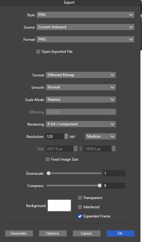

      The export settings used:

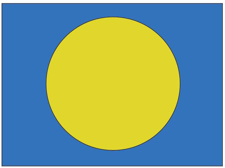

      Exporting Artboard 1 works as expected:

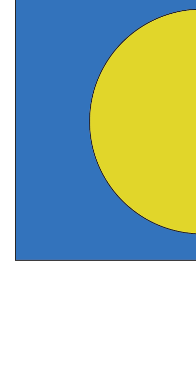

      Exporting Artboard 2 is vertically offset:

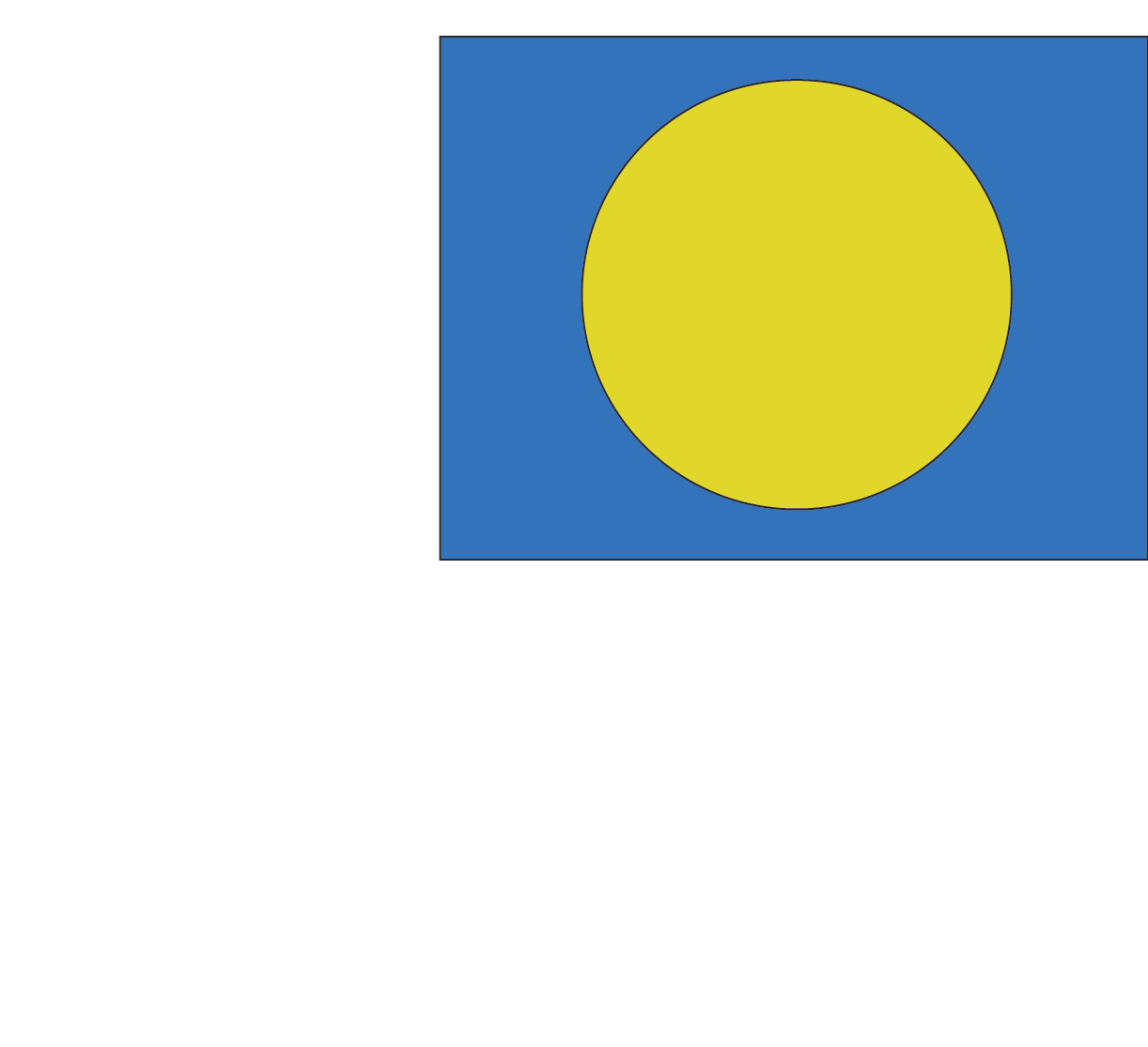

      Exporting Artboard 4 is horizontally and vertically offset:

        @LoginError There are indeed issues when exporting as PNG with the "artboard" option selected, while selecting "canvas" or "objects" works fine. This is likely a bug.
          VectorStyler @LoginError
          @LoginError I opened a bug on this.
