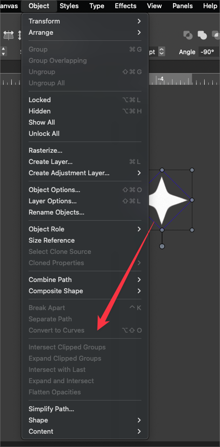

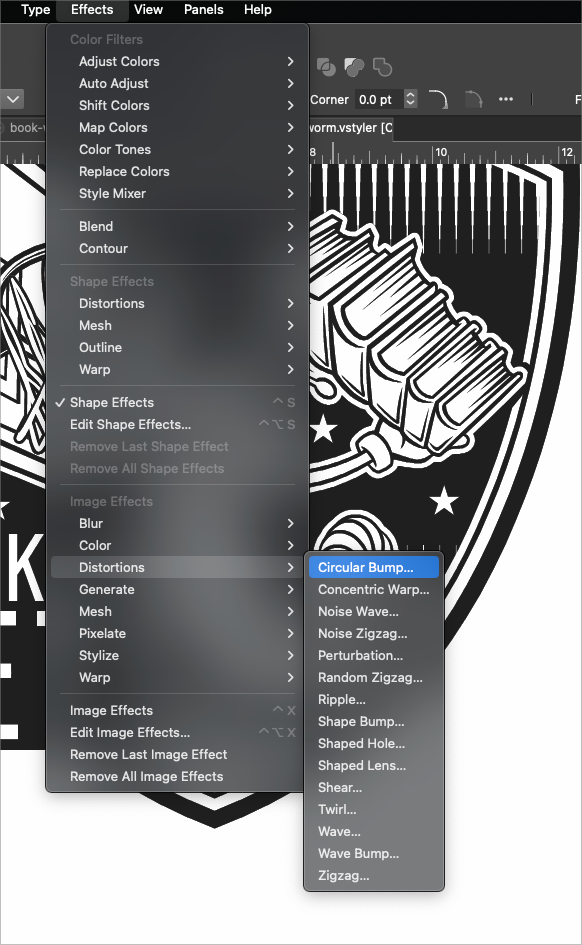

      How do I expand distortion results? Or is it converting it onto a raster? It's confusing.
      I was using the effects>distortion>circular bump

        @Boldline Convert to Curves
          Boldline @Li Xiao
          @Li-Xiao said in How do I expand distortion results?:
          I was thinking that also, but it's grayed out when I go to try to use it.
          Here is a link to a new file with the same result: 0_1713837815156_distortion test.vstyler
          0_1713837038566_1afbf021-980b-4e5c-ba97-0322489f0872-BLD 2024-04-22 at 21.50.00.png
          • L Online
            Li Xiao @Boldline
            @Boldline I didn't notice that you were using the Circular Bump in the Image Effects instead of the Shape Effects. Why not use the Circular Bump in the Shape Effects? In the Image Effects, you can use Rasterize
