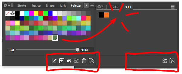

I can't add swatches to external (locked) color palettes.
Tried to consult online guide but not quite confident with how VS color palette managent works.
In other apps I just drag and drop color swatches from panel to panels but here they seems locked.
I cannot figure out how to unlock the latter. I guess I miss something out in the VS palette concept.
Can you help?

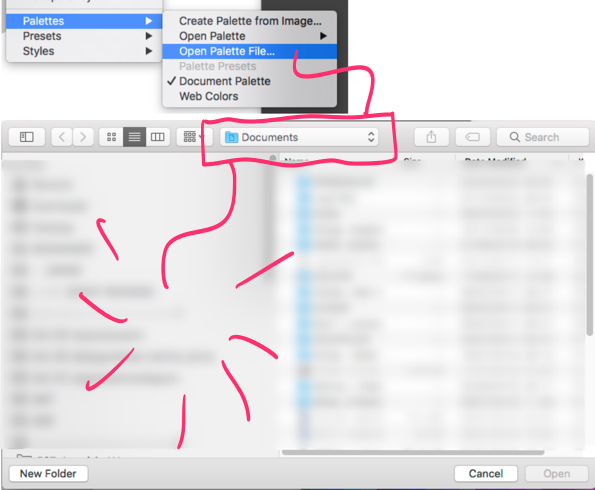

You can open a palette file using the Panels -> Palette -> Open Palette File command.

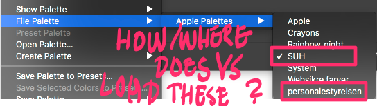

Sure, but no clue of where from VS load the palette-files.Is there a specific VS ressource folder to access?
@Raaskot said in I can't add swatches to external (locked) color palettes.:
I was thinking about external palettes (other than VS), in case you have the file.
Yes, but when using OS Finder/search I cannot reach them on my harddisk.- How does VS pick them?
- Is it possible to remove palettes from VS?
@Raaskot Those palettes are from MacOS. VS picks them by asking the system the available palettes.
They might be in ~/Library/Colors/, but depends on how they were created (by other apps).
VS cannot create these kind of palettes
