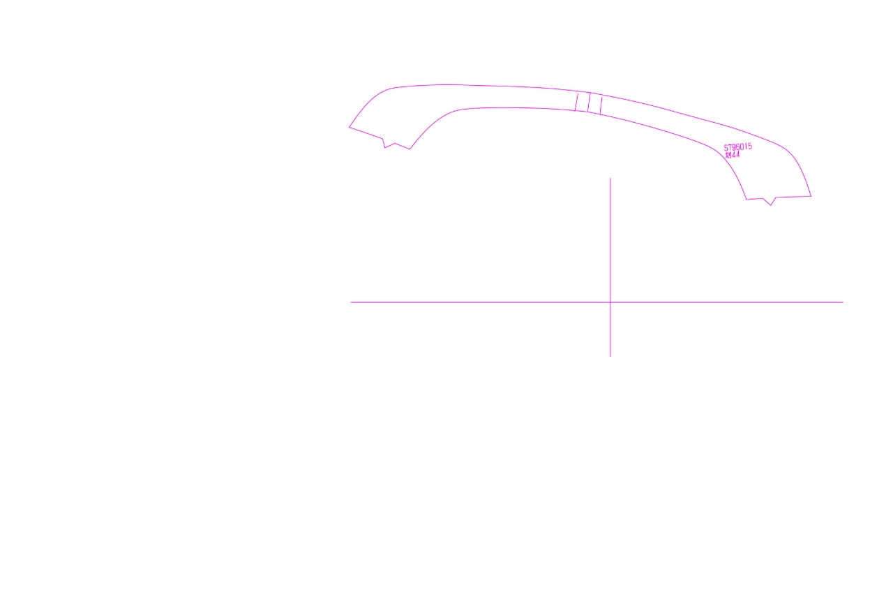

    A symmetrical figure, rotated by an unknown angle. How to adjust the angle to normal level? Or how to measure the angle of two anchor points?

        @VectorStyler This is a Chinese carving software, this is the rotation tool, it is very easy to use for the rotation correction of such symmetrical graphics, very fast and convenient.Perhaps VS can also add this feature. https://youtu.be/HQV-DTiMLMY?feature=shared

            @monsterfox , my strategy is to draw a rectangle between the two reference points, then do arctan(height/width) and you have the angle to apply.
