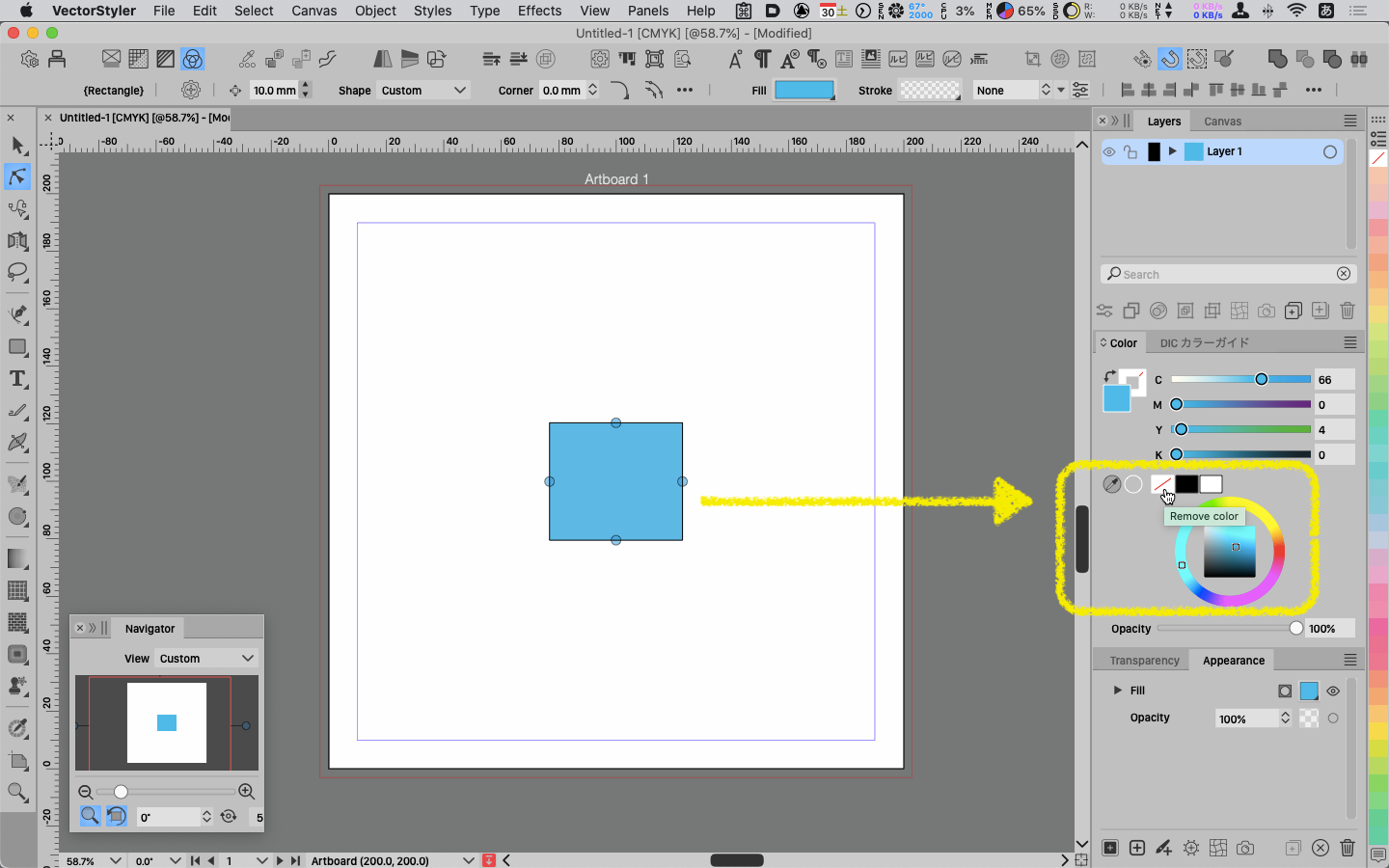

      I frequently use remove color from this state.
      Would you consider adding this shortcut or command in the future?
      Adobe products are like this.
      [ / ]: non fill
      [ < ]:color (in VS it is vector & pixel)
      [ > ]: gradient (white in VS, no shortcut)

              What I need now is a shortcut for [Remove color]. That is to correspond to the tip at the bottom of the color panel.
              In my previous statement I misspelled "non fill".
              I see no need to change the role of the other tips right now.
              First: Remove color
              2nd: black
              Third: white
              The examples are only for Adobe products.
              1st: Color
              Second: Gradient
              Third: no color
              The Adobe formula is not necessarily the best. However, it is based on the assumption that many people are familiar with it.
              If necessary, it can be changed in the future.

                      What I need is a shortcut to [ remove color button ] or its menu command.
                      Arrangement of buttons
                      Function of buttons
                      These are as they are now.
