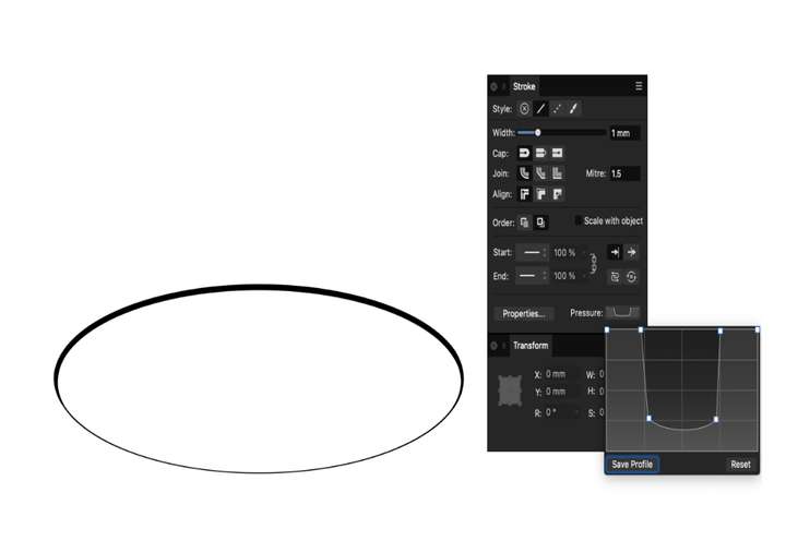

Is there a facility to accurately change the line thickness of a shape like an ellipse? Affinity had a line pressure feature where you could modify a graph to determine the line thickness. Attached is an example of what I mean.

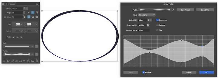

Thanks for information. I will try and upload my file again using a different format. In the mean time I will check out the stroke panel etc.!
Thanks Subpath form the screen shot. I will check it out.
I was able to create an ellipse with the correct thick and thin stroke and saved it. I could only do this using a vertical ellipse and then rotating it to a horizontal position.
I found the stroke panel more useful than the AD one.
However when I try to draw another ellipse it has the same thick and thin lines as the saved one. How do I draw a new ellipse without any previous attributes?

In VS the previous attributes are used when drawing new objects.
In this case you can clear the width profile on the new object by clicking the solid stroke icon in the stroke panel (second from last).
