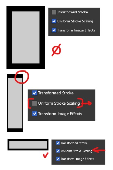

 I had the idea that it was sufficient to activate a single option to scale an object's stroke proportionally when rescaling an object. I only managed to do this by activating 'Transformed Stroke' and 'Uniform Stroke Scaling'. Is this correct or is there another option? Thanks

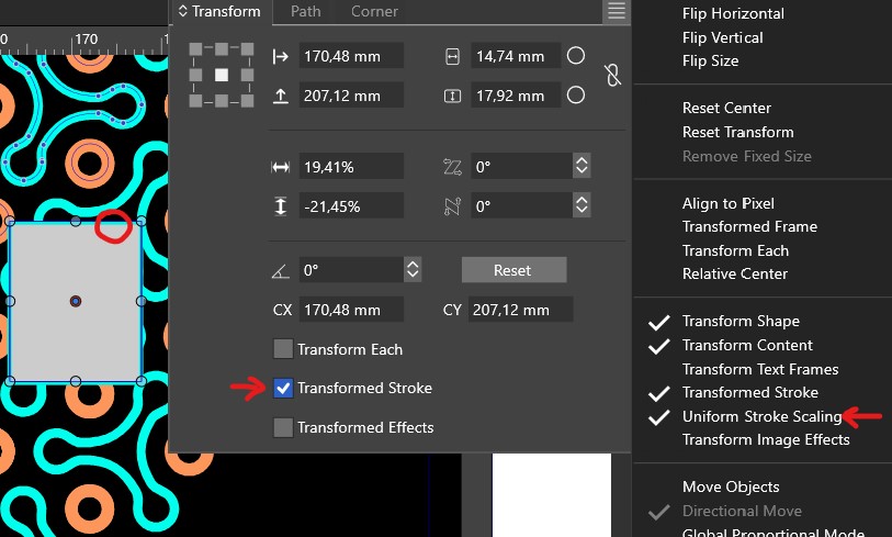

 @VectorStyler Would it be possible to add the "Uniform stroke scaling" in the Transform panel ? Thanks
 @Pat It is in the panel menu.
 @VectorStyler Yes, I know & it is also fine but since it is tied to "Transform stroke", it would be logical IMHO to have it directly in the panel beside "TS" (no need then to check in the panel menu).
