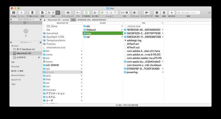

                                      @861475_VctSt Yet another suspect for the slowdown: there might be too many files in the temporary files folder.
                                      This folder unfortunately is hidden in MacOS and it is different per system.
                                      VectorStyler scans the content of this folder for files that might have been created in previous runs (in case of crashes) to avoid accumulating such files.
                                      • 861475_VctSt8 Away
                                        861475_VctSt @VectorStyler
                                        Temporary files are about this.
                                        /private/tmp
                                        With VS ver. 1.0.062 it starts up in 7 seconds, but with ver. 1.0.005 and later it takes about 90 seconds.
                                        Then I would think, in layman's terms, that there must have been something between these versions "regarding startup". What do you think?

                                          VectorStyler @861475_VctSt
                                          @861475_VctSt said in VS startup time:
                                          Yes that would be a correct assumption.
                                          But I also tested both 1.2016 and 1.1062 on a MacBook Mid 2012 with Catalina on it. And both start up around 7 seconds.
                                          So I suspect that there might be something here that can be fixed.
                                          BTW: that temp folder is not the one used by apps (temp folders are served by MacOS, and have long /generated names).
