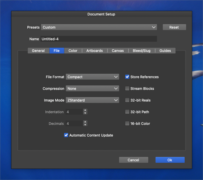

    Add an option in "Document Setup" to save current configuration as a new template option?

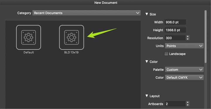

          I currently have a custom template I made, but it only shows in the "recent" folder, not in any other folder. Is this normal?

            @Boldline said in Add an option in "Document Setup" to save current configuration as a new template option?:
            Is there a way to add templates to that custom folder from the local drive?

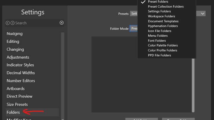

            Use the "Template Folders" (not the custom templates) for this, set up the folders in settings, and then just copy templates to those folders.
            For example, I could create a template in the custom template folder and then later save a copy of that template to a different folder I previously linked to the "new document setup" panel?
            Sort of, the folders are specified in settings.

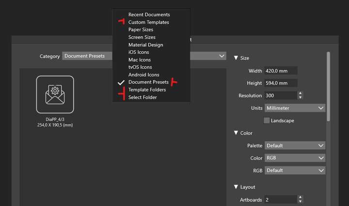

                @VectorStyler It's still abstract to me. I have to test the practical application of these possibilities. For me, the important thing is to be able to create a new document and save it as a template for future use (in AI "save as template") ☺ .

                    Not sure how that works, but using template folders (set up in settings) and then saving to those folders will make the files templates.

                      @VectorStyler Here's some new information for me. I suppose that it is here:

                        Yes, you need to add one or more folders to the list, with the "Document Templates" mode selected.
