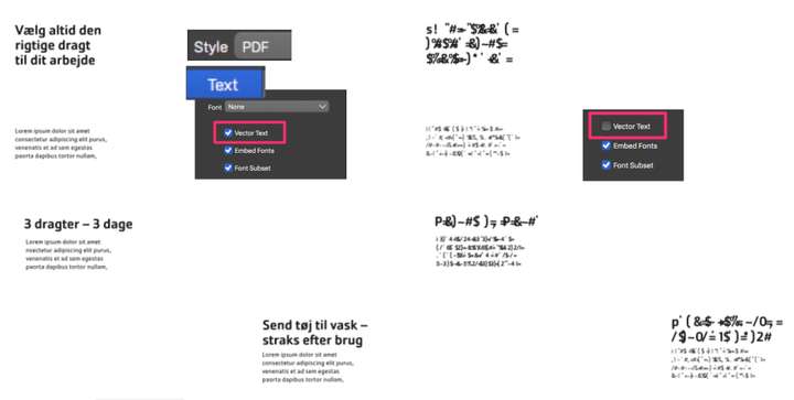

I (still) have issues with pdf export from VS: All text turns into gibberish.
Only when "Vector Text" is turned on it renders legible, but then text selection in exported pdf is not possible.
Is there any other way I can solve this?
I've attached vstyler and pdf-files

@Raaskot It works here as it should but I don't have the Cachet typeface so
I changed the font to SF Pro:0_1707263847991_pdf-font-OK.pdf
Is the same happening with any font?
@Raaskot Could be something to do with the font. I will try to replicate and fix this issue.
