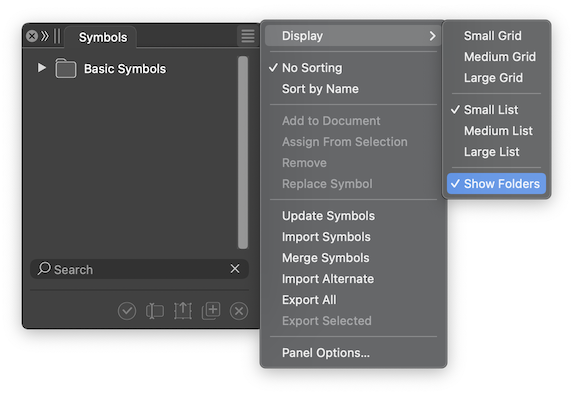

            b77 @B-Vs-V
            @Pat Also: make sure 'Show Folders' is enabled:

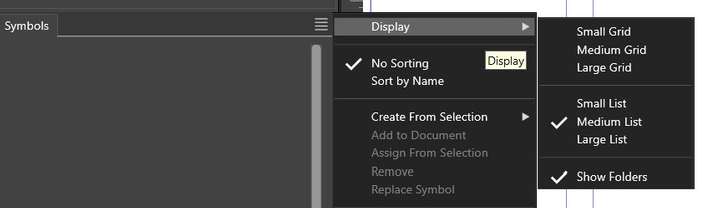

            • B Offline
              B-Vs-V @b77
              @b77 Thanks ☺ yes, it is & I can see folders in one of my files:
              apparently, "create group is missing" in the symbol panel options.
