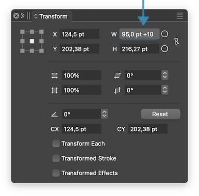

@VectorStyler Here it works when '+10' overwrites the highlighted value:

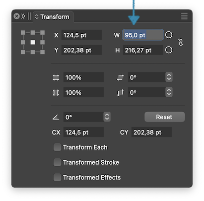

When the value is not highlighted, it doesn't work:

@b77 said in Maths operation in panels:
The problem is with the "pt" in the middle of that expression.
