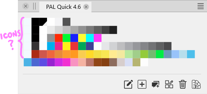

    Firstly, is there supposed to be a group icon in the left light blue swatch next to a group row? All I see is the light blue square that looks like another swatch...
    Secondly, is it possible to change the arrangement of the swatches within a group? Note, I am not referring to "sorting" the palette by name, hue, etc., I mean changing the position of a swatch when "no sorting" is the chosen option.
    I thought this was possible, but I may be confusing this function with one in another app.
    If anyone is able to do this, please let me know so I can figure out if I have something configured incorrectly; thanks! 😌
    @Victor-Vector yes, there is an icon there. Looks like the light UI theme has some colors wrong.
    To change the color order manually, drag and drop a color to a new position.
