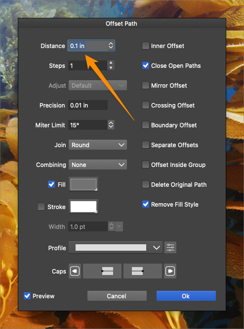

    unable to get the kind of precision I need with the slide feature in offset path
    3 Posts 3 Posters 4.5k Views 2 Watching
      When I am creating an offset path, I am unable to get the kind of precision I need with the slide feature. I'm using inches as my measurement type. There's no easy way to get it to slide in smaller increments and I have to manually edit the number. Is there a way to make this more sensitive, especially with lower numbers?
      Here is a video of the issue
      0_1702607711423_f71da083-c325-4518-b43e-cf70b457e7fe-BLD 2023-12-14 at 21.34.04.png

        Li Xiao @Boldline
        @Boldline I tried moving the slider, and it was 0.01in.
          @Boldline In Settings -> Decimal Widths what is the value at "Inch Decimals"? Try increasing it (set to 3).
