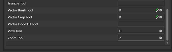

  • Thx for your reply. The thing I meaned is that you can assign the multipurpose shortkey yourself as a user in the shortcut application menu. Then there is no need of a warning that the key is already taken or that the double chosen key is not working.
    This is how this feature is looking in Affinity:
    Both the Brush Tool and the Crop Tool are assigned with the letter B and there is a two stroke icon with arrows that indicates that the shortkey is assigned multiple times.
    @FastVector said in Multi purpuse use of shortkeys:
    What happens when you press B?
  • @VectorStyler When clicking the letter B you get first the Brush tool and when pressing again you get the Crop tool. You get the same sort of cycle as with returning to the previous tool. Only now it is applied to only the tools with the letter assigned. So the function of returning is for the multipurpose assign keys disabled to go back to the previous tool. And when you go back to only one purpose assigned key the returning to previous tool is enabled again.
