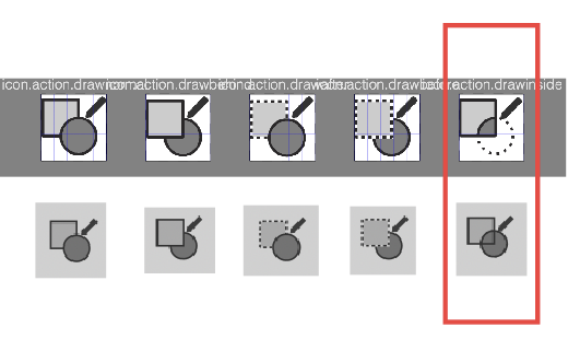

    Are the icons you sent me the same as used in 1.2.005? Draw Inside is not matching.
    must use gray tones, will be mapped by the current theme.
    Why? Icons like these are also pure black and white/none (apart from antialiasing)?
    @Ayo said in Drawing Place Icons:
    My mistake: no other colors than levels of gray for now (so black and white are ok).
    @Ayo it might be that the draw inside icon was not exported correctly.
    I will check this later.
