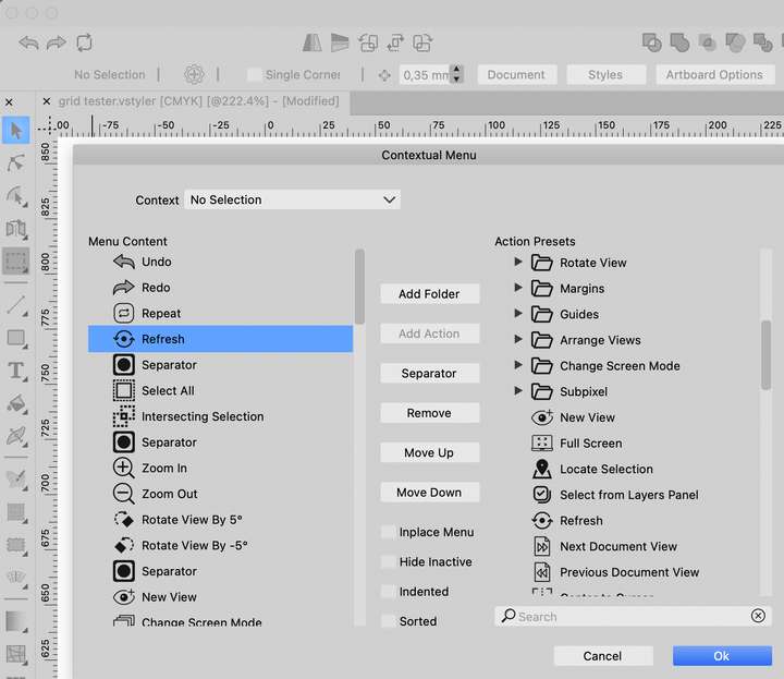

      Can someone help me with customizing the contextual menu?
      Or is there a good tutorial/video somewhere?
      I don't quite understand how this works.
      I do see a corresponding effect what I change with right clicking with the mouse in pop-up menu, but I see no visual change in the contextual menu bar.
      Example: I want the refresh button after Undo/Redo.
      How to fix that?
        b77 @Ayo
        @Ayo You need to drag the command from the right column
        to the left column under 'Redo': https://recordit.co/10EVY5k7tN
        • AyoA Offline
          Ayo @b77
          @b77
          Thank you but I have that already there.
          b77B 2 Replies Last reply Reply Quote 0
            b77 @Ayo
            @Ayo OK, then is 'Refresh' failing to work when you click it in the context menu?

                      b77 @Ayo
                      @Ayo The context panel/bar at the top has two rows.
                      The first row can be customized with 'Customize Toolboxes': https://recordit.co/6eqzTvjlL4
                      The context menu is the menu displayed by the app when you right-click
                      with the mouse or Ctrl-click with the trackpad.
                      This one can be customized with the 'Contextual Menu' command from the VectorStyler menu.

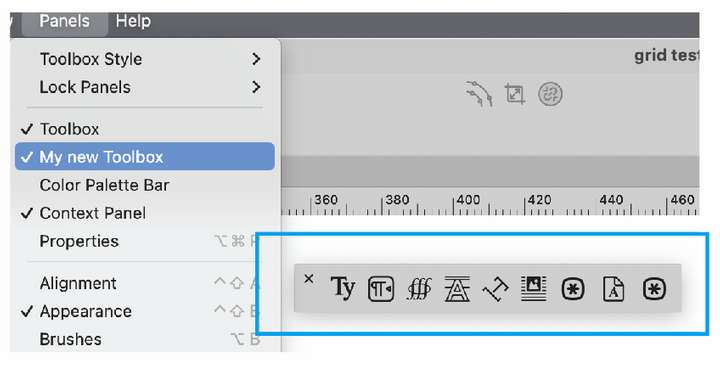

                                • AyoA Offline
                                  Ayo @b77
                                  @b77 said in Customizing the contextual menu:
                                  that's why it is edited with 'Customize Toolboxes' (plural)
                                  I was thinking more of this kind of plural
