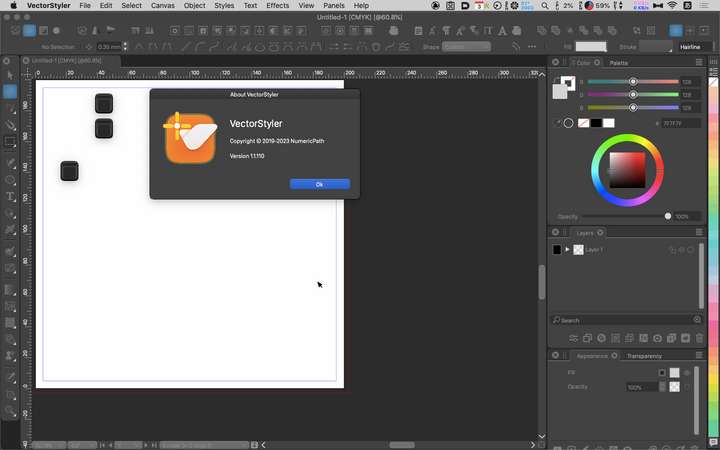

                            @b77
                            Intel Mac
                            VS 1.1.110 & 1.2.001
                            After installing and using both
                            Both had problems and I deleted the beta version.
                            I did not use them at the same time.
                            I mean I used them alternately in a day.
                            The main symptoms are
                            Theme is only Default and cannot be changed.
                            I really want to use "Flat light grey" but I can't change it.
                            Palettes are not displayed properly.
                            Palettes that were iconified in the beta version are displayed in 1.1.110 (this would be great for 1.1.xxx if it worked properly).
                            fig.
                            Anyway, the problem seems to be workspace related.
                            Therefore,
                            I decided to install the beta version on another machine.
                            I planned to switch to ver. 1.2.xxx at this time, but will do so a little later.

                              VectorStyler @861475_VctSt
                              @861475_VctSt said in Can I use them together?:
                              1.1 cannot show iconified panels, the panels are still open.
                              A screenshot might help.
                              I will try to figure out what happens here. One thing I will try to have in the next build is to have separate folders for 1.1 and 1.2
