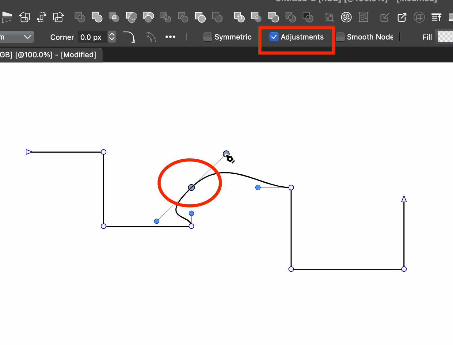

    1. Use the Pen Tool to draw a few straight segments, like in the image below. Make sure you hold down SHIFT so you can snap to 45/90 angles. Also, make sure the "Adjustments" checkbox is checked in the Context toolbar.
    2. Go back a few anchors (so it's not immediately next to the last one - like the one circled in the image) and make some adjustment to it to change it's type.
    3. When done with the anchor adjustment, hold SHIFT and continue adding line segments.
    SHIFT will no longer have effect to constrain the line segment. But once you draw a line segment, the following segments will be constrained again.
    So basically, once you edit an anchor, the SHIFT-constraint will not work until you draw the 2nd segment (after editing the anchor). Hope it makes sense. If not, will make a video.
