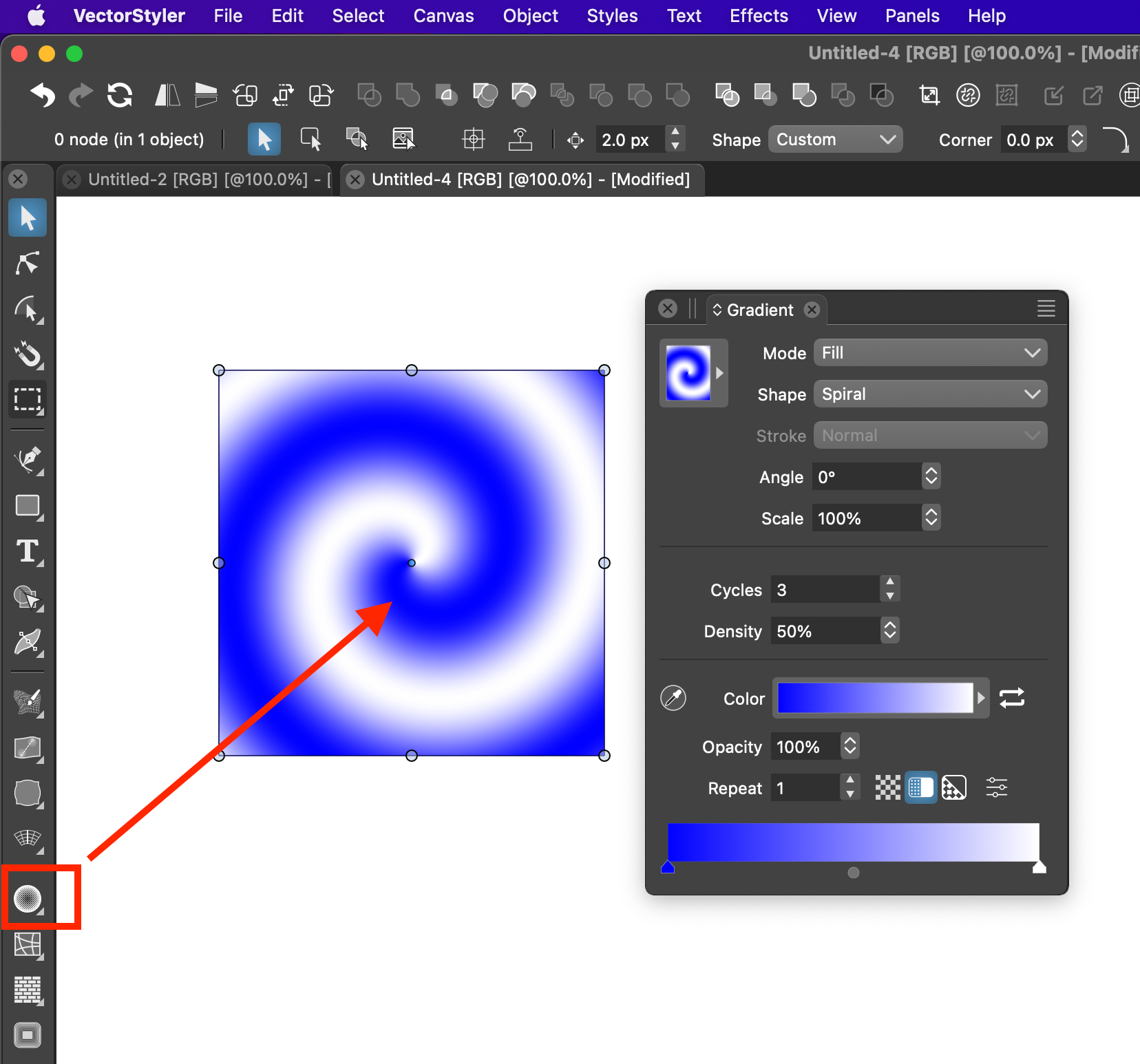

No editing handle visible for spiral gradients
I am reading the docs regarding spiral gradients. The section shows the various editing handles for the spiral gradient. However, they are not visible.
https://www.vectorstyler.com/documentation/gradients/tool/#editing-spiral-gradientsWhen you assign a different gradient shape (eg conical, linear, concentric) the editing handles are visible. Am I missing something or is this a bug?
(The screenshot here is somewhat misleading. It shows the Pointer tool is active and the rectangle shape is selected. But this is only because when I press the key combo for making the screenshot, the keys temporarily engage the pointer tool. In reality, the Gradient Shape Editing tool was active (circled in red).)
VS 1.1.100

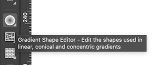

The Gradient Shape Editor can edit only the shapes used in linear, conical and
concentric gradients, not spiral shapes in spiral gradients:More info here: https://www.vectorstyler.com/documentation/gradients/shapes/
Editing a conical gradient's shape:
Another example with concentric:
Thanks, but did you look at the link I posted to the documentation? It shows a small screenshot/illustration of the spiral gradient with the editing handles, also explaining which handle does what.
So the tooltip contradicts the documentation - or vice versa.
@pentool Yes, I did look at the link.
The Gradient Editor gizmo (G) is shown in that image, not the Gradient Shape Editor.
Ah, maaaaaaaaaaaaaaaaan! What the heck is wrong with me!? I spent all this time... and didn't realize this. Sheesh....
Anyhow... thanks for making me realize I need glasses...

VS lets you create custom shapes for the gradients AND lets you edit the gradient shape
itself (its nodes) with this Gradient Shape Editor.Here's a quick video: https://i.imgur.com/TgqkFt5.gif
@pentool The spiral gradient shape cannot be edited as a shape, you need the concentric or axial modes for that.
