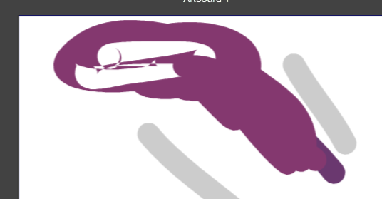

Sometimes I get a result like the picture attached - is that something you are trying to fix already in an upcoming build?
@Boldline The issue is caused by stroke expansion on complex shapes. The cleanup scheme is not working well. This is in the backlog, but the fix will not be soon.
