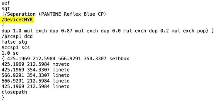

    Colour - Default CMYK or CMYK
    When exporting to a .eps file the Separation Method is always shown as DeviceRGB...
    How do I force a .eps file to use DeviceCMYK, as per the attached image?
    @VectorByName The when you double click on the spot color in the main palette, what is the primary color mode?
  • @VectorStyler I've tried using RGB, CMYK and LAB so far and all appear to result in DeviceRGB in the exported eps file though I'll test some more to confirm that is indeed the case...
    Edit: I've just changed it back to CMYK and that seems to have fixed the issue...
    Many thanks
