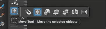

    In VS, there is the "Move" tool which hides all other options for edit and only allows moving to occur. I've used this when I have multiple small objects that I want to rearrange without having to worry about accidentally modifying the selection

    And there is the simple answer ! That certainly cures all the issues I'm currently having and works at any zoom level without issue - thanks ! I wasn't aware of this tool as I have a self-limited tool setup here - there are far too many tools in the VS arsenal that I don't need (unlike my real workshop 🙂 )
    However 🙂 I'm not sure I understand why it is necessary to have yet another tool do the job of the transform tool - it works perfectly in AI without swapping out to another tool ??
    One thing I did notice with the move tool is that you can option-drag to clone another text block - a saving feature.
    The move tool doesn't pick up the text frame as well as the block text from the text tool - you have to be pretty accurate to just get the edge of the frame - it occasionally works by grabbing the internal text, but not always.
    Thanks for that snippet - it's now on my M shortcut key (like most CAD apps curiously 🙂 )
