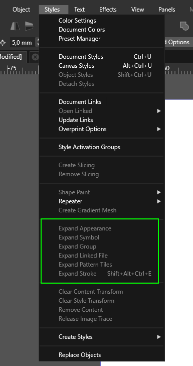

      Correct me if I am wrong. Not so long ago, when I wanted to divide a dashed line into pieces, I reduced the stroke size to 'Hairline' and then used expand. I am trying to do this now , but scaling down the stroke also increases the number of segments. Is there any method to break the line into individual pieces? I need to make a perforation lines for my cutting machine.

            @Igull Here is a way that works for me : https://recordit.co/JMmXdttLhG

                    Unfortunately, by expanding the stroke, the dashes end up as small rectangles rather than as single lines - picking up the outline of the stroke width.
                    Understandably, expanding the stroke width would produce that - it doesn't work at zero stroke width sadly which might have been a workaround 🙂
                    It would be great if there was an option to expand the stroke as simply lines of any thickness rather than outlining the current stroke. During the cutting process, the outlined strokes would be cut as rectangles rather than as lines - doubling the cutting times and most likely over-burning the material if the line "rectangles" were say hairline.
                    AI has the same issue, I never found a satisfactory way to do this other than writing a small script that created true individual physical dashed lines rather than a visual style.
                    Neil
                      VectorStyler @Igull
                      @Igull said in Break apart the dashed line into individual elements.:
                      This is why we have to set it to Hairline (zero) width
                      IgullI 1 Reply Last reply Reply Quote 1

                        Mmmm, my stroke set doesn't include hairline, it starts at NONE, 0.05mm, 0.1mm etc - I have "Convert Stroke Widths to Unit" checked in Size Presets/Stroke Width.
                        I've just done a prefs reset back to default and I can confirm it works using "hairline". However, that option isn't available when stroke widths are converted and neither NONE or 0.05mm work - NONE won't allow a dashed effect and 0.05mm produces rectangles 😞
                        A bug ??
                        Neil
                          VectorStyler @Igull
                          @Igull Not a bug, since it can be removed in preferences. But if you type 0.0 as a width then it should set it to hairline.

                                @VectorStyler What do you think about adding Expand Dash as a feature?
                                  VectorStyler @encart
                                  @encart said in Break apart the dashed line into individual elements.:
                                  I actually added this (quietly) to the backlog 2 days ago 🙂
