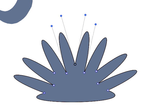

    I made this as a variant from the pucker effect question, using an ellipse > effect: distortion > spikes and played a bit with the shape effects. Then converted to curves.

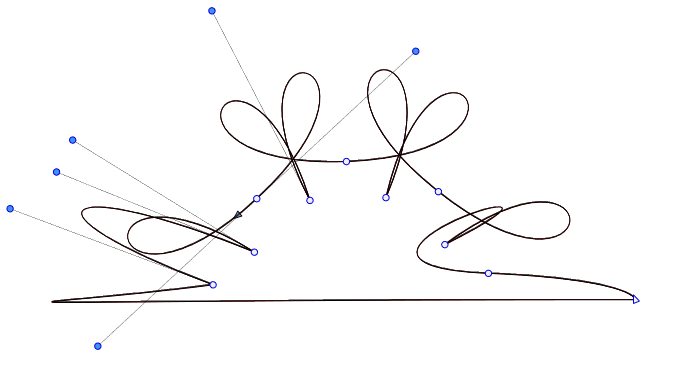

    1. I tried to just delete the bottom half by selecting nodes: the shape lost integrity

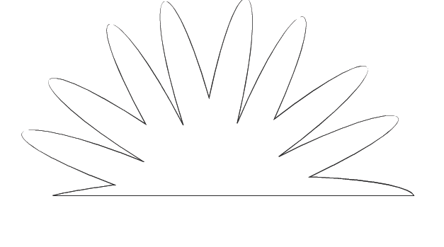

    2. Then I did a boolean exclude with a rectangle as top element, that looked better - but any node manipulation makes the shape lose integrity.
    There are no shape effects on the object, it is a curve. Just wondering what is happening here.
    @syllie I think the bug here is in the spikes effect. It leaves the nodes with the "smooth" flag, but they are should cusp now.
    Just select all the nodes and set the Cusp node mode, before deletion.
  • @VectorStyler Thanks - that indeed seems to be it.
