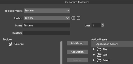

  • @Pat
    As an alternative. Create a new toolbox. I think it does not take up much space and you can display it or close it as needed.
    Select "View > Customize > Customize Toolbox" and click on the "+" sign next to the toolbox field.
    Functions can then be dragged and dropped into the new toolbox and also removed.
    Of course its also possible to create different toolboxes for different needs.
    To call your Toolbox choose "Menu > Panels" its below "Toolbox".
    Here is a picture of my toolbox with "Colorize" in it.

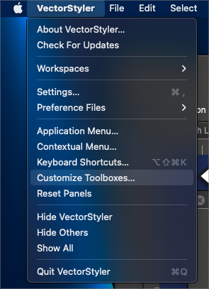

  • If you're on Mac, it's under the main "Vectorstyler" menu at the top left side

  • @Subpath @Boldline Thank you both for your replies. I'm on W & it is under View > Customize...
