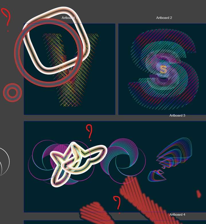

I think it is a bug (regression?). I opened an old file and I can't find the integrity of the objects I created to test VS. Yesterday, I could not duplicate a shape with "Alt-drag"...

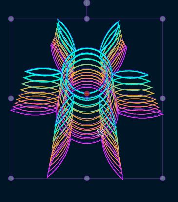

@VectorStyler There is still a bug with copy/paste:
I can select & move this object:

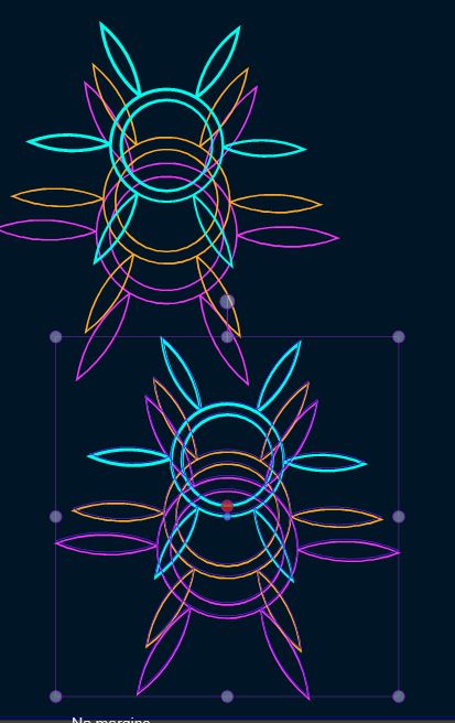

but I can't get it copy with Alt-drag:

@VectorStyler I've sent you two files. I've noticed that saving the original file as a temporary one modified the object.
@Pat yes, the duplication is can be replicated. I will try to fix this ASAP.
@Pat Seems to be a mistaken configuration in the release.
A workaround until the next build would be to fix this in the configure.xml file.
On Windows, this can be found in the VectorStyler1.0\vector\data\resource\ installation folder
Search for "allownodestackreseting" in the XML file and set it to "no".
