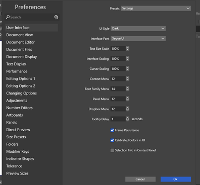

    Can you post a complete screenshot how the Preference
    Panel and the VectorStyler Ui look on your screen ?
    Here a screenshot with the Preference Panel, where my screen
    is set to 1366 x 768 pixel
    @VectorStyler
    it could be a panel problem other than screen resolution?
    @Subpath I think on Windows there is also a system settings that scales all apps up.
    And it is used on High DPI screens.
