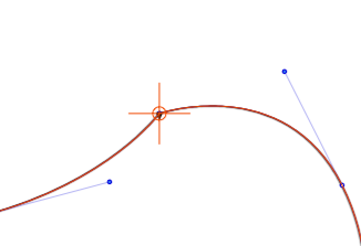

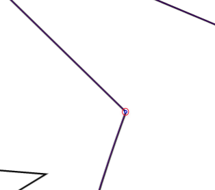

            Several of us have requested a way to know when we are snapping to a node or another attribute in the design. You added a large red circle with crossed lines. Speaking for myself, I don't think it needs to be really large as it is now. What about a small red circle that appears for a second and then disappears? I included a pic of how it currently looks and a second image of what I am envisioning.
            I know for me, I love the way I can pull a node handle in to the center of a node and it creates essentially a cusp point. Illustrator offers this and I love it for it's efficiency. I can do this if I have "snap to point" activated, but then I have no choice if the snap-to indicator is active as well. I might like the indicator more if it was small and less obtrusive - maybe trying that first? But I'm partially hoping for a toggle to show or not show the indicator when snap to point is active.
            Also, the snap to point still seems too strong when adding points with the pen tool close to an existing node in the proximity. Maybe shrinking the radius of influence around existing nodes? It all seems a lot more improved from before, so that is good.. it's getting closer!
