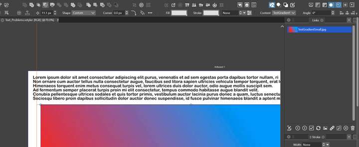

How to Snap-Align A Bitmap Image to The Left Side of A Text Object Using Mouse?
Kindly download the following file:
0_1673711663372_Text_Problems.vstyler
Drag the bitmap image and try to snap-align it to the left side of the text object using mouse:
I found it difficult to snap it to the left and right sides of the text object, but it is okay for its top and bottom parts. Are there some options to fix it?

@Subpath Did you also find it difficult to snap my bitmap image to the left side of the text object?
@gotanidea Yes, this can be replicated.

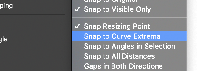

This is caused by the individual shapes in the text object.In the snapping panel, disable "Snap to Curve Extrema".
@VectorStyler Thanks Admin

but as @VectorStyler wrote, disable "Snap to Curve Extrema"
fix it
