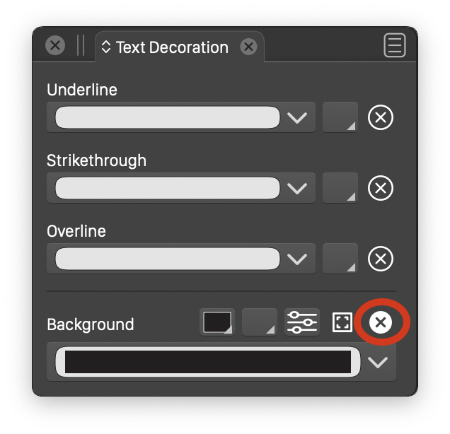

How to Edit Text Background?
Please see the screenshot and file (created using the latest version of VectorStyler (version 1.1.070)) below:

How to remove or scale up the text background from the Appearance panel?

@gotanidea Managing the background fill of a text in VectorStyler is done in the Text Decorations panel.
The Appearance panel is used to stack fills / strokes / effects on the text as an object.
To remove the background, click on the red circled icon in the Background section:
@VectorStyler said in How to Edit Text Background?:
Thank you!
