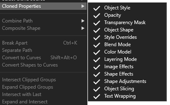

for clones, I found the following:
select the clone(s) and go to
Menu > Object > Cloned Properties
and deselect "Object shape
and the clone will no longer follow the movementwhen you select it again, the link is restored

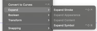

In the case of Reference, I used Styles>Expand Symbol. The option is disabled when it comes to Copy. Such a bit of searching in the dark.

It get s a little complex when it comes to references, but generally:
Clones
- Edit -> Detatch Clone or Detatch Source
References:
- Styles -> Expand -> Expand symbol
- See 'Expanding References' section in VS documentation)
One should read it thoroughly to understand what VS does during expand.
I find it hard to jump from menu to menu to look for the right place (Expand symbol) so I customized my right click menu like this, so expand whatever is always available right where I am working, which I recommend if you work with references. Adding a submenu with clone features is easy peasy.

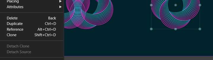

@Pat To detach a clone: select Edit -> Detach Clone.
To detach a source object from all its clones: Edit -> Detach Source. -
@VectorStyler these are grey, can't do it:

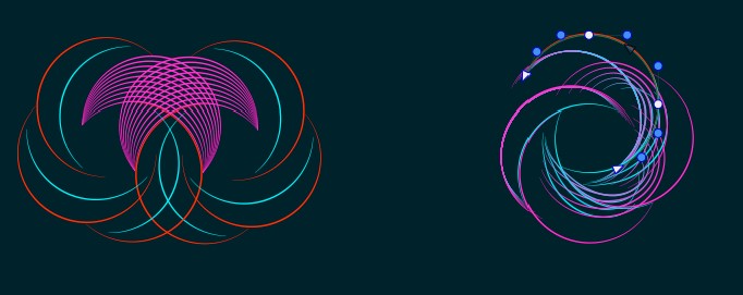

@Subpath @encart @Ingolf Thank you. I didn't try yet to export but 'expand symbol' doesn't give any result... even worse, some strokes disappeared :
and impossible to come back, Ctrl+Z became inactive. I had to close and reopen the file:

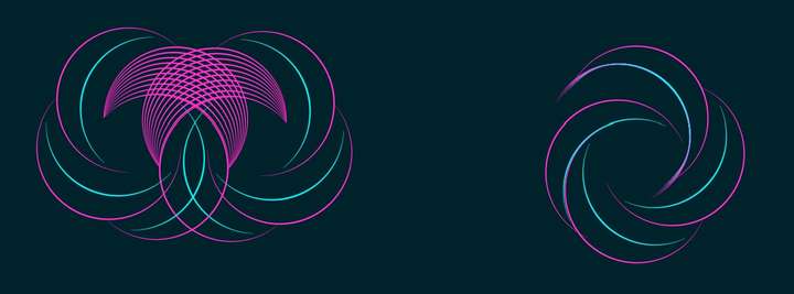

@VectorStyler I've just sent you a file with this "detach" issue. Whatever I do, I can't modify the middle scheme without affecting the left one.
@Pat Got the file and added this to the backlog.
@Pat Yes, the problems can be replicated with the file.
Looks like there are still issues with blends inside symbols (references).
Will try to fix this ASAP. -
