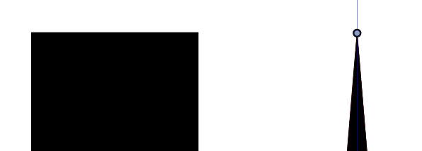

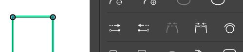

Is there an easy way to go from a two-node shape to a one-node shape with the node in the middle? I think I did this in Illustrator but I don't remember how:

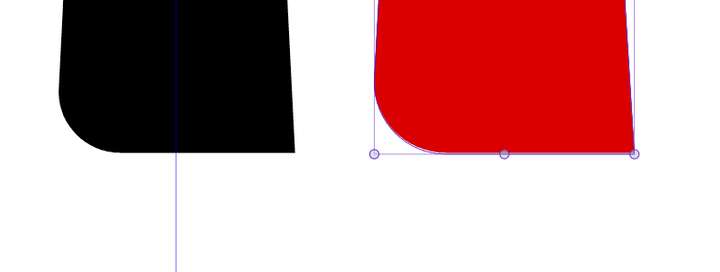

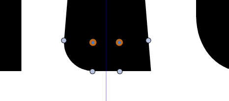

Also, I don't understand this behaviour: I want to use the corner editor tool and deal with these two node points but only one sharp corner becomes rounded:

There might be an extra node at that corner (two or more overlapping nodes), or the shape is not closed? Send me that example with the corner and I will try to figure what is going on.

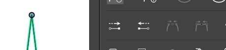

@VectorStyler A 'Merge Nodes at Center' button would be faster.
@VectorStyler It is not adding or deleting a node. As @b77 mentions it is more a merge nodes at the centre of the shape.
@VectorStyler No extra node. It works as expected before I move two nodes at the middle of rectangle.
After moving these two nodes, I can't get two rounded corners.

@VectorStyler ... and -at least on this test- the corner editor tool works very well ! you may not see it here but at the beginning, it was a rectangle which I rounded the corners
Thanks !
