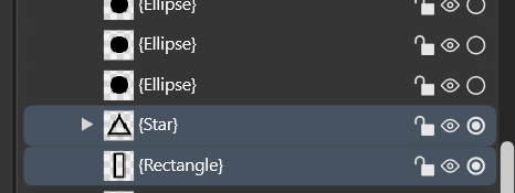

When I select several objects on the artboard, I can only move one object at a time in the layer panel. I can't select layers with the "Shift" key if the objects are scattered and the "Ctrl" key makes all the layers disappear except for the last selected object.

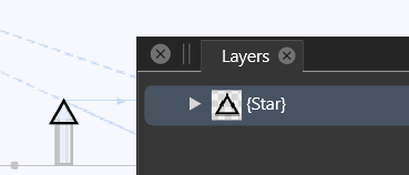

After Ctrl:
@PatrickM In the Layers panel options (panel menu -> Panel Options), disable the Isolate on Control+Click. Then Control can be used to select multiple objects in the panel.
Also: enabling Select Highlighted and Highlight Selected in the Panel Options, (first column around center), will keep the selection on the canvas and Layers panel in sync.

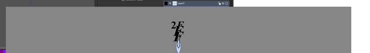

Impossible to see the bottom of the layer panel. I assume this is a bug.

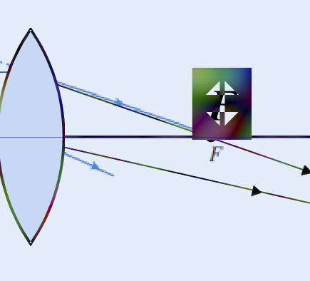

... and suddently by clicking on the artboard, I get this:
By undoing, I could see that VS add fill noise.
@PatrickM Seems that something is dragged from the layers panel. Press Esc to cancel the drag&drop.
I will try to replicate this. -
@VectorStyler 'esc' was my first move but it didn't do anything.
@VectorStyler and yes, I wanted to move objects from a layer to another one.
