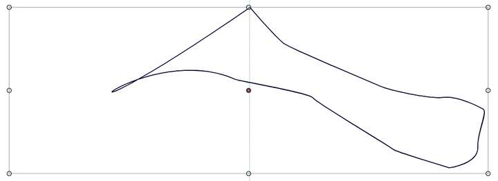

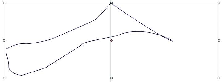

I just wanted to check this:
- Shape minus a bit - expected behaviour when flipping
- Pen tool drawn shape, closed, flipped horisontally but not around centre (with any pref setting)... why?
Short:
Added two objects handdraw with the pen tool:
Whatever the setting, I see the exact same behaviour. In this case there is a different behaviour when flipping the triangle vs the shape with more nodes, both created using the pen tool.
@Ingolf Added this to the backlog. I will try to solve it ASAP.
