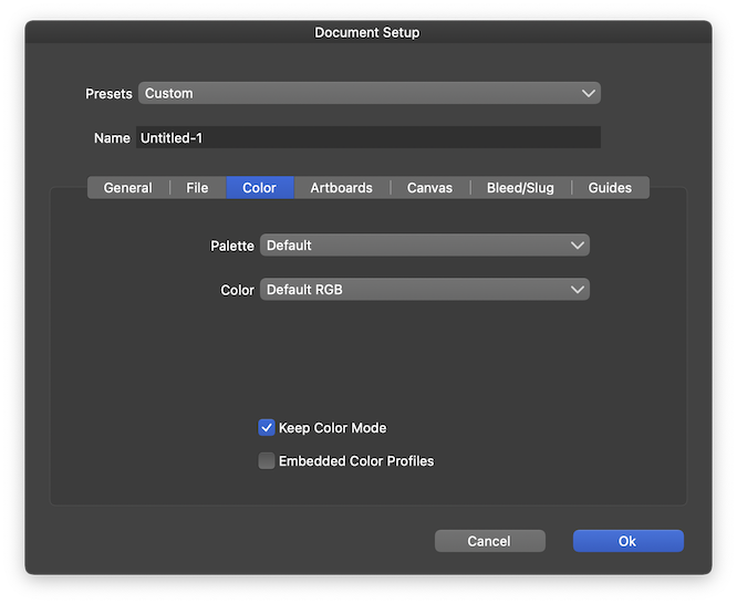

@William-Kansepa One thing to check first: select "New Document Setup" and in the "Color" tab look at what is selected in the Color drop down.
Select the color mode you need and confirm.
What is showing now in the document tab?When a document setup view is confirmed (New or just Setup), the settings are stored for the next new document. This could cause issues.

@VectorStyler Btw, in Document Setup > Color tab the 'Color Palette' menu is placed before the 'Color Mode' menu:
@VectorStyler Thank you, but I had already done that prior to posting on the forum. Something is definitely amiss.
