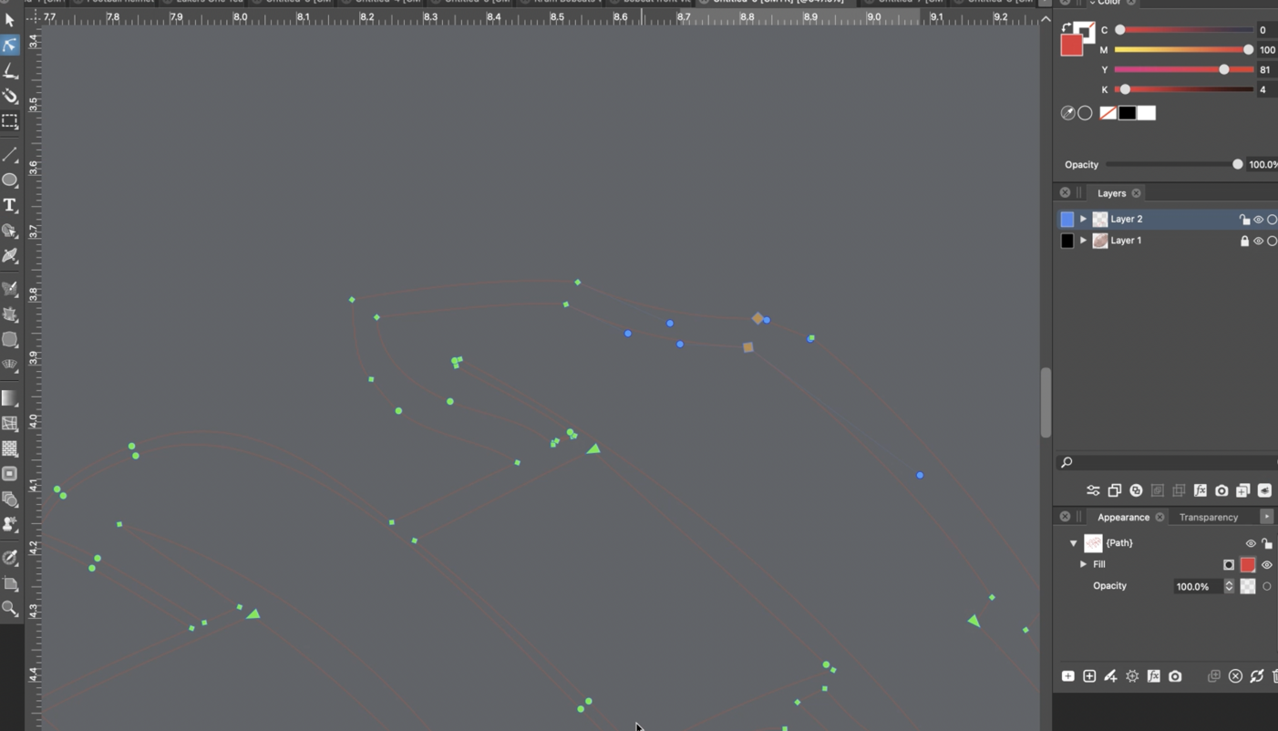

On the M1 mac laptop, if I switch between programs and back to VS, the screen space inside VS goes gray temporarily and any paths appear invisible for a few seconds before correcting themselves. I have the display set to "metal" in the preferences.

This is a screenshot of the issue. Where it is solid gray, there is supposed to be artwork.
@Boldline These issues are possibly related. The second case (switching between VS documents) could be caused by the redraw when documents are switched. This is done intentionally, but it should be much faster on an M1 mac.

This is certainly related - on the Mac Mini with 16GB of RAM and not many other programs open and VS using less than 1GB of RAM) - just switching back to VS from using another program, the screen is gray and stays that way until I press a tool or scale the document view. Short video of this happening.
